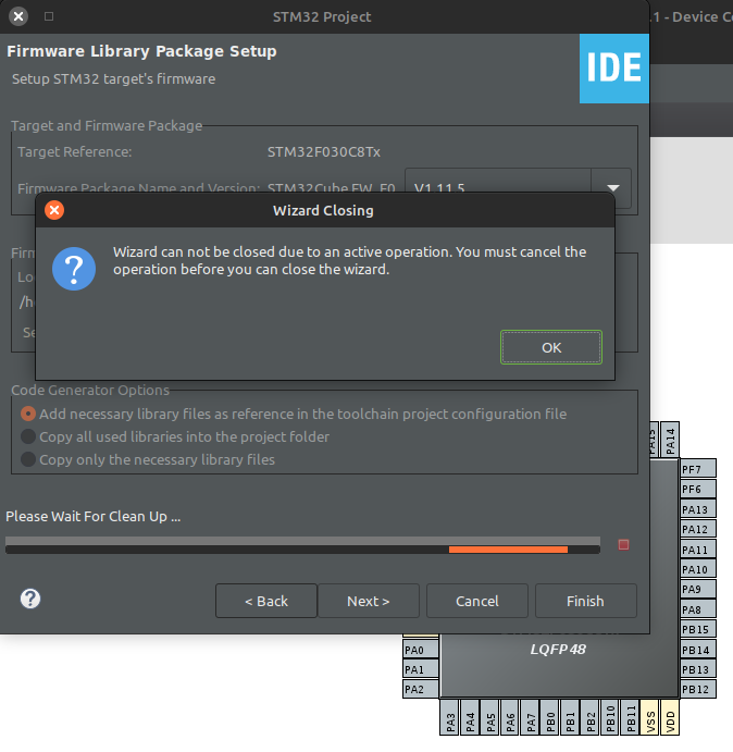

I've created a new project and the IDE has stuck in the "Please Wait For Clean Up" state for more than an hour, and I cannot cancel it! Should I wait for another hour or should I kill the process and then lose all my work in the workspace?

CPU load: 101%
1. I killed the Java process. In recent versions of the IDE (>1.12.1) this means to lose all my work (happened me more than once), so I was afraid of killing it.
2. After I killed the process and when I tried to load the IDE again, closing every other processes, the IDE refused to open. Noooo!
3. I killed again the Java process, and then I deleted the folder for the newest project from the hard-disk.
4. I loaded the IDE again... and this time it opened, so I didn't lose my work, only the newest project.
5. I created the project again (with no other apps running: Java had the 100% of my CPU). Success so far.

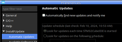

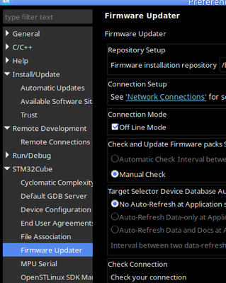

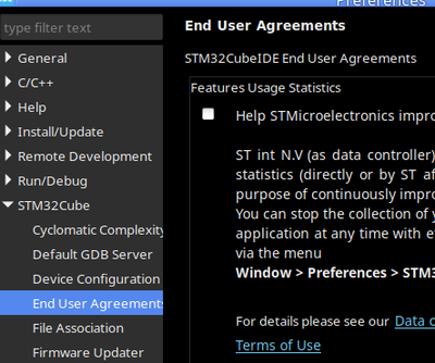

2024-09-24 2:36 PM - edited 2024-09-24 2:53 PM
i use 1.13.1 and 1.14.1 (at work) , both running fine (most time - you know...).
But : remove all update/info/login settings, to freeze the actual state and have no "bad surprise" !
So: cancel login, an in settings disable update/search for new.../send info ...offline mode.
then much better, stable. Try.
Update only, if you need it ! Because you use new cpu, or want/need new features - but this is pandora's box also.
so: menu -> window -> preferences ->
