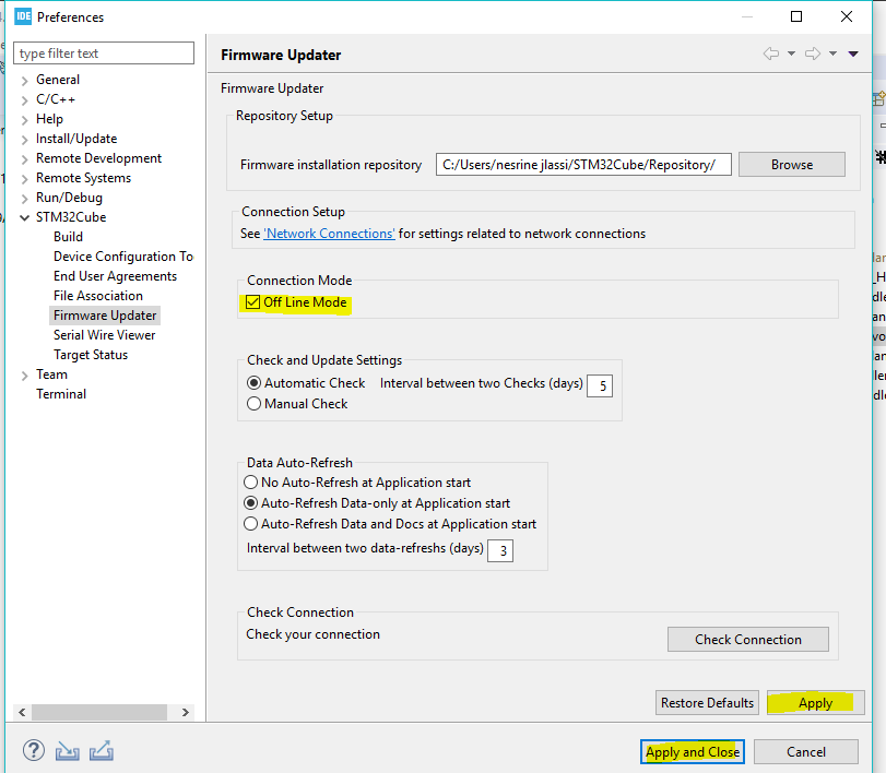

2020-04-15 7:02 AM
Hello @spica lai
You have to do this following step:
Best regards,
Nesrine
2020-04-15 5:14 PM
thx a lot for your reply.
I have done want you have said.
however, when I clicked Embedded Software Package Manager again, nothing came out. The manager dialog doesnot come out.
Here is my experement:
