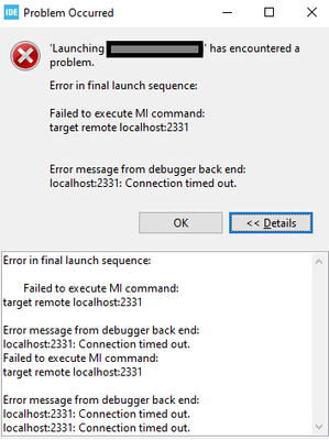

When I try to run the application I get the following error:

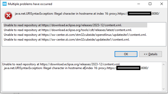

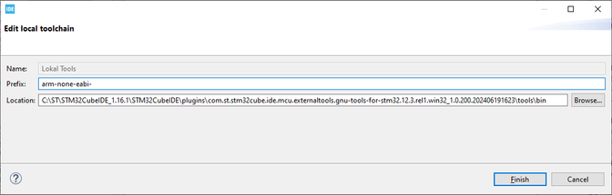

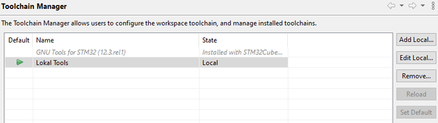

I have tried to manually set the workspace toolchain to local in the toolchain manager.
When I open the toolchain manager, I get an error that it has failed to fetch the toolchain list, in addition to four repositories that it cannot read:
Ignoring the message and setting the local toolchain as it follows
I get the same error when running the code on the MCU:
What should I try to do to fix the error?

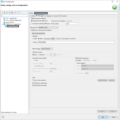

To ensure that CubeIDE can communicate with the SEGGER J-Link and program your STM32F433 MCU correctly, you should verify the J-Link configuration in CubeIDE.
1- Go to Run -> Debug Configurations.
2- In the Debug Configurations window, under GDB SEGGER J-Link Debugging, check if your J-Link device is selected in the Target tab.
3-Make sure the correct device is selected in the Target tab and that the settings match your hardware setup.

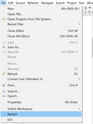

Also Clear Cache:
Sometimes, cache issues can cause problems. Try clearing the cache in CubeIDE by going to File -> Restart

Hello Ghofrane
I tried rebooting as you mentioned, but it made no difference.

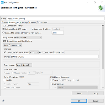

Here my debugger settings:
*my MCU STM32F446

1- First let's try to use the SWD (Serial Wire Debug) interface for debugging purposes. Segger J-Link devices support both SWD and JTAG (Joint Test Action Group) interfaces for debugging ARM Cortex-based microcontrollers but using SWD with a Segger J-Link offers a reliable and efficient way to debug your target device.
2- Click on "Show command line," copy the command, open your command prompt, paste it there. Before proceeding, ensure that your J-Link is connected and your board is ready. Finally, share the log, please.

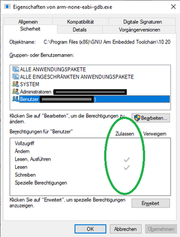

I have installed the Arm GNU Toolchain for Windows:
gcc-arm-none-eabi-10.3-2021.10-win32.exe
I have added the path to the environment variables (admin+user) as follows:

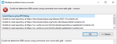

Now I can call the function from the cmd line (user), but when I ask for the version number nothing happens, it gives no response and stays there:
When I try to run the code in STM32CubeIDE (user) I get the same errors:
I tried then to run the command via admin cmd and got the following:
Here are the user permissions for the file:
Thank you for your help.

The error message you are encountering indicates an issue with IDE's ability to access or read the repository at https://download.eclipse.org/tools/cdt/releases/latest/content.xml. This problem could be due to various reasons, such as network issues.
1- Check Network Connection:
Ensure that your internet connection is stable and that there are no network issues preventing STM32CubeIDE from accessing external repositories.
2- Proxy Settings:
If you are behind a corporate firewall or using a proxy server, configure the proxy settings in STM32CubeIDE to allow it to access external repositories.
3- Firewall/Antivirus:
Check if any firewall or antivirus software on your system is blocking STM32CubeIDE from accessing external repositories. Temporarily disabling them can help identify if they are causing the issue.
4- Test with Full Path:
Try running the arm-none-eabi-gdb command with the full path to the executable to see if it provides the version information. For example, C:\path\to\arm-none-eabi-gdb.exe --version.

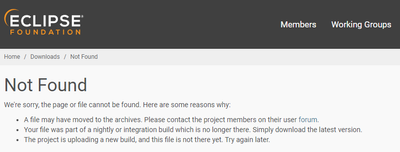

When I click on the link you mentioned, it says "not found".
I have proxy settings setup in STM32Cube IDE and I can prove they work in the settings with the check connection button:
