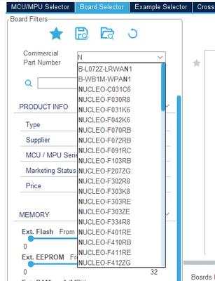

when creating a new project, and I start typing in the "Commercial Part Number" field, the cursors moves to another field after the first character.
Here I was trying to type "Nucleo" and the cursor moved to the other filed after the first keypress.

I didn't reproduce the behavior with 1.15.1:
When I type N the text is kept in the field and list of available devices occurs.
Could it be something related to your keyboard? did you try the same on another PC?
