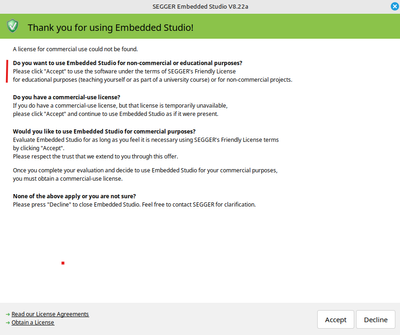

2025-10-07 7:54 AM - edited 2025-10-07 8:02 AM
"Embedded Studio is available under SEGGER's Commercial Use License (CUL) (single user). This license is portable, meaning it is not limited to a single PC, and it can be stored on a J-Link, acting like a USB dongle. This allows full use of Embedded Studio on any computer. "
Just great (not) ;)
