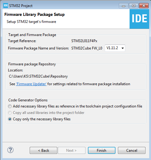

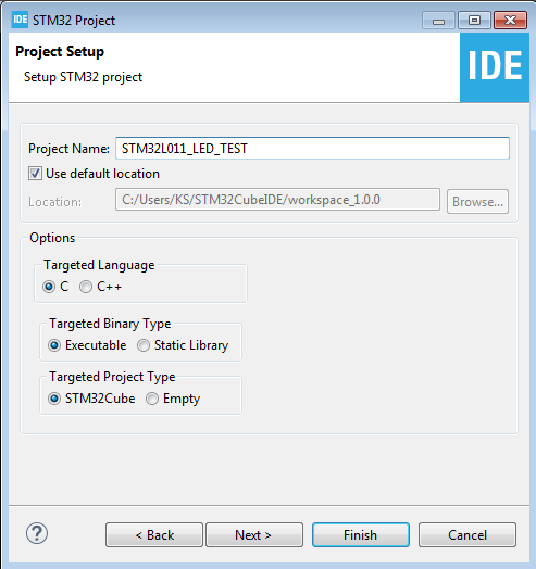

Here's how I do it so far:
Next step:
...and "Finish.

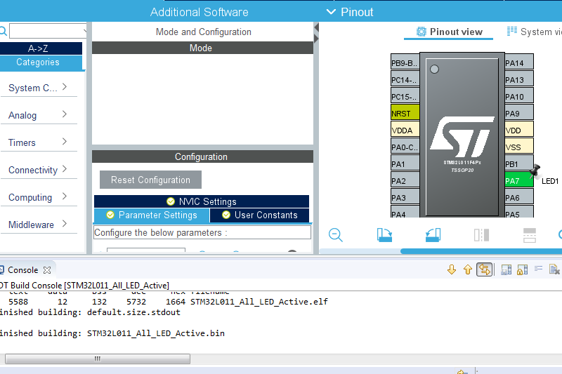

a) Set PA7 as a GPIO output and rename to "LED1" (PA7 has been connected to the anode of LED and cathode of LED to the ground.

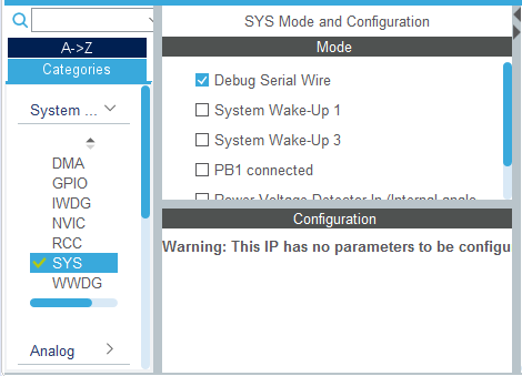

b) Debug serial wire - selected as below:
And no other options selected in that window (maybe that's the problem?)

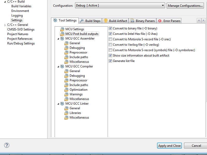

Just two lines in "while (1) {}". Now I have to set bin and hex options:
And that's all.
