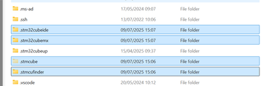

2025-07-13 11:03 AM
so...just :
Please try to
-Close STM32CubeIDE
-Delete all those files from your PC: .stm32cufinder, .stm32cubemx, .stm32cubeide and .stm32cube
then restart the STM32CubeIDE and retest again.
2025-07-15 6:54 AM
Thanks, that worked for me with 1.18.1
