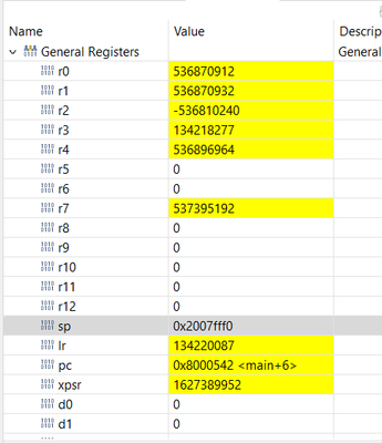

my register when breakpoint was hit and the error appeared:
The error in debugger console:
Note: automatically using hardware breakpoints for read-only addresses.
set *(int *)0xE000EDFC=*(int *)0xE000EDFC|0x7F0
Breakpoint 1, main () at ../Core/Src/main.c:77
77 HAL_Init();
Any thoughts you could share with me?
Thank you.
