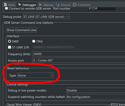

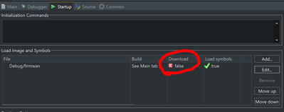

1) Go to your debug configuration (Run -> Debug configurations...). In the Startup tab, select Download: false.
2) In the Debugger tab, select Reset Behavior Type: None.
2023-11-29 6:09 AM
Great. It works just as epected.
Thank you!
2023-11-29 6:18 AM
You're welcome. If you can hit "Accept as Solution" on that post I'd appreciate it.
