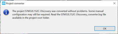

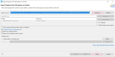

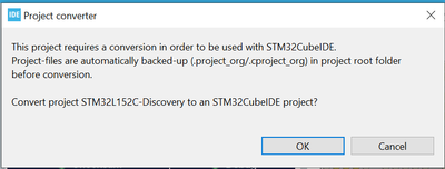

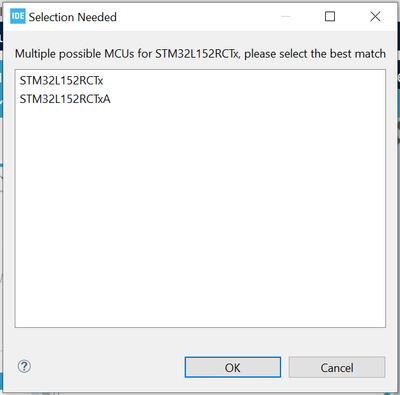

Please follow these steps to open this example in STM32CubeIDE,
1- Open STM32CubeIDE
2-Click File-->open projects from file system or Archive
3-Import project from the repository "...\Repository\STM32Cube_FW_L1_V1.10.4\Projects\32L152CDISCOVERY\Examples\LCD\LCD_SegmentsDrive\SW4STM32\STM32L152C-Discovery" as shown in the below figure
4- Click to convert the project
5- Choose the device you are using
6-Click "OK" to convert the project:
7-Build the project
I hope this help you!
