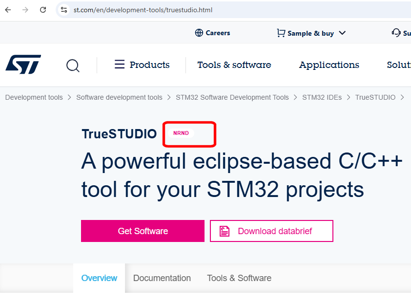

2024-10-28 4:39 PM - edited 2024-10-29 2:29 AM
If it was already not recommended a year ago, it's not going to be recommended now!
As shown on the Product Page:
PS:
In fact now the future is moving away from Eclipse (CubeIDE) towards VSCode ...
