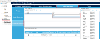

Hi @Ping1,
1. Here is an example screenshot for generating the LL driver:
2. Yes, it will work

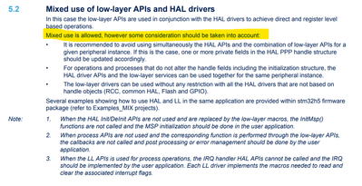

You can take a look at this example in STM32CubeH5. If you encounter any problems, please attach your IOC file.
3. A specific area is already reserved for USER CODE. Otherwise, you can keep a complete copy of your project and regenerate it later. Your code will be deleted, leaving only what was generated by MX. You will then be able to compare the two versions of the code
