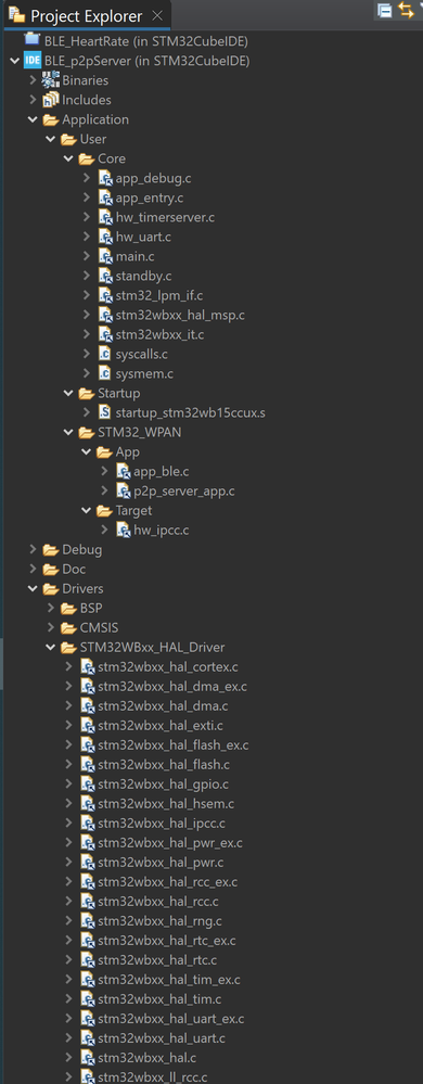

This is how the project looks like when it was created. Notice that almost all the source files have the little arrow in the bottom-right of their icon, noting they are linked resources (they actually live outside the Eclipse project's root):

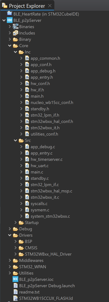

I fixed it by moving the Eclipse project files to the root of the project, removing the "Application" folder that hosted mostly links, moving the very few "real" files from there to their "usual" place (usual as in projects created normally, not with the "example selector"), fixed include paths etc. It compiles and runs. It looks like this (see how the files are real files under the project root, not linked resources, and the "Application\User" folder is removed):

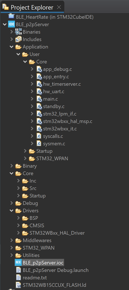

Seems like all is good, right? well, now I want to start tailoring the example for my use-case, so I want to make some changes in the .ioc file ("Device Configuration Tool"). But if I re-generate code in the tool (even without making any actual changes in the configuration), I get this ugly thing back:
See how this "Application\User" folder came back from the dead, with its linked resources. I searched for a long time to find where can I change this behavior of the Device Configuration Tool, but didn't find it. The Code Generator doesn't do this for projects created from scratch.

For anyone interested, I solved this on my own some time after I asked here.
I did two things that helped: added the following line to the .ioc file:
ProjectManager.UnderRoot=trueI also removed this line from the .ioc:
ProjectManager.ExampleSource=MxCubeFwand removed these lines from the .project file (this might happen automatically after code generation when doing the above changes, don't remember):
<nature>com.st.stm32cube.ide.mcu.MCUNonUnderRootProjectNature</nature>
<nature>com.st.stm32cube.ide.mcu.MCUCubeImportedExampleProjectNature</nature>This solved my issue.
