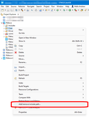

For adding Include Paths, I note that it's now (v1.13.0) possible to do this straight from the right-click menu in the Project Explorer:

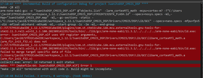

Thank you Mahmoud, and everyone for your help. So, I just followed carefully this post, and I got further than before. Now the compiler recognises the FIR functions and shift-click works as well. That said, I am facing other errors:

That shows that it is now compiling correctly - just the link is failing.
Please post the message as text (copy & paste) rather than a screenshot

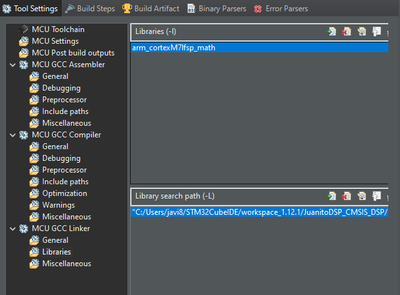

Ok Ok, I made it work. What was causing the earlier problem was that I didn't select the correct library. It seems that, on the MCU GCC Linker Libraries,
for cortex-M7 based MCUs (as my stm32H723), you can link one of these three:
arm_cortexM7l_math
arm_cortexM7lfdp_math
arm_cortexM7lfsp_math
And I was using the M7l_math. It seems that the first one is intended for non-FPU, while the others use FPU. Because my project has FPU enabled, I just needed to change the library for any of the other two. A more experienced mate told me that the difference between these two is that, the M7lfdp uses double precision, while the second one uses single precision. With the first one, you get a more precise result, at the expense of more time spend calculating it.
