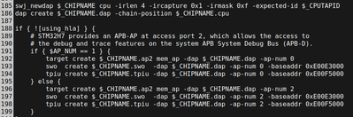

...dont know, what your editor shows at 191 --- no AP_NUM
i see:
btw i have no idea, what this means... (backup file , then edit ...maybe as sudo)
i would just try to remove the > if { $ ... < and the else also.
just remains there:
target create $_CHIPNAME.ap2 mem_ap -dap $_CHIPNAME.dap -ap-num 0
swo create $_CHIPNAME.swo -dap $_CHIPNAME.dap -ap-num 0 -baseaddr 0xE00E3000
tpiu create $_CHIPNAME.tpiu -dap $_CHIPNAME.dap -ap-num 0 -baseaddr 0xE00F5000and see, what happens.

oh, i was viewing openocd files instead of the ide ones
2025-01-27 7:27 AM
after patching out the AP_NUM

...dont know... i would try instead :
target create $_CHIPNAME.ap2 mem_ap -dap $_CHIPNAME.dap -ap-num 2
swo create $_CHIPNAME.swo -dap $_CHIPNAME.dap -ap-num 2 -baseaddr 0xE00E3000
tpiu create $_CHIPNAME.tpiu -dap $_CHIPNAME.dap -ap-num 2 -baseaddr 0xE00F5000

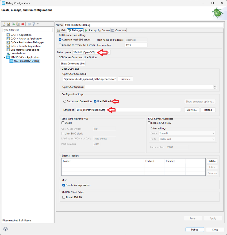

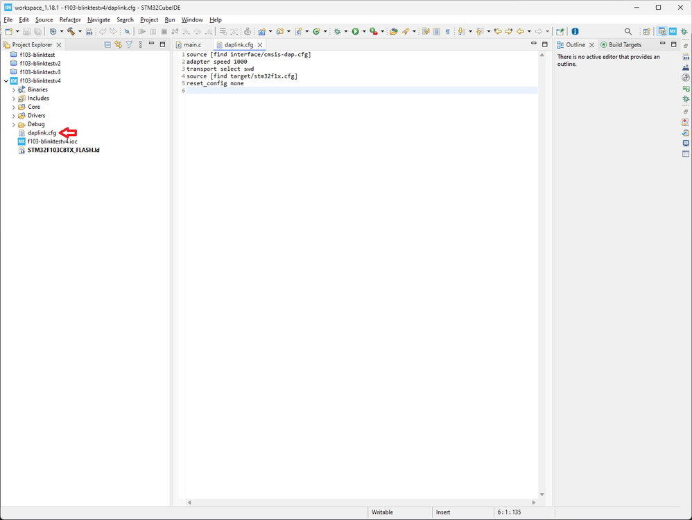

I found the steps to upload and debug with a cheap daplink. See my post on imgur (https://imgur.com/a/how-to-use-daplink-cmsis-dap-with-stm32cubeide-OrpcsvX) - or I'll copy paste its contents below:
source [find interface/cmsis-dap.cfg]
adapter speed 1000
transport select swd
source [find target/stm32f1x.cfg]
reset_config nonelappend pre_shutdown_commands { resume }

Hi, @ckocagil ,
i tried with daplink.cfg script to connect an old blue-pill (with STM32F103C6 cpu) and yes, its working fine !
Info : Listening on port 6666 for tcl connections
Info : Listening on port 4444 for telnet connections
Info : CMSIS-DAP: SWD supported
Info : CMSIS-DAP: Atomic commands supported
Info : CMSIS-DAP: Test domain timer supported
Info : CMSIS-DAP: FW Version = 2.1.0
Info : CMSIS-DAP: Serial# = 070000011a5a5bb6000000000001ceeca5a5a5a597969908
Info : CMSIS-DAP: Interface Initialised (SWD)
Info : SWCLK/TCK = 1 SWDIO/TMS = 1 TDI = 0 TDO = 0 nTRST = 0 nRESET = 1
Info : CMSIS-DAP: Interface ready
Info : clock speed 4000 kHz
Info : SWD DPIDR 0x1ba01477
Info : [STM32F103C6Tx.cpu] Cortex-M3 r1p1 processor detected
Info : [STM32F103C6Tx.cpu] target has 6 breakpoints, 4 watchpoints
Info : [STM32F103C6Tx.cpu] Examination succeed
Info : starting gdb server for STM32F103C6Tx.cpu on 3333
Info : Listening on port 3333 for gdb connections
Info : accepting 'gdb' connection on tcp/3333
Info : device id = 0x10006412
Info : flash size = 32 KiB
Warn : GDB connection 1 on target STM32F103C6Tx.cpu not halted
undefined debug reason 8 (UNDEFINED) - target needs reset
Warn : GDB connection 2 on target STM32F103C6Tx.cpu not halted
[STM32F103C6Tx.cpu] halted due to breakpoint, current mode: Thread
xPSR: 0x01000000 pc: 0x080004a4 msp: 0x20002800So i can use my -until now useless- cmsis-dap debug probe also .
Great !
(But usually using st-link V2 or V3 , its just nice, to have a working alternative debug probe. )

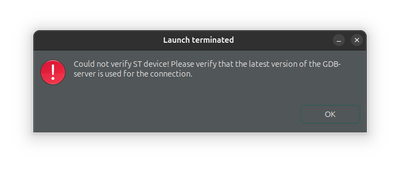

Why is the topic you guys split it into showing up as read only? Also actually in debug configurations you can set blackmagic probe as a gdb server, so do not tell me it is not supported. Which means st clearly has no issues with it, they even seem to support it. Also i do not want to buy an st-link because i want one tool for all cortex-m devices, and not one tool for ST's STM32, one for TI's msp or whatever and so on.
I am writing here because i cannot in the new one.
