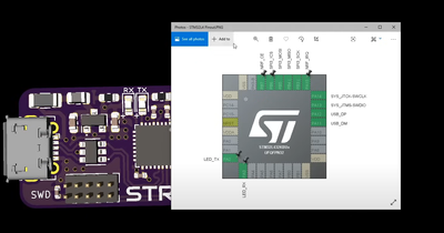

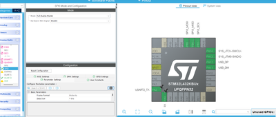

Im a bit new. I'm following a tutorial and i cant find the SPI_ICS like the guy on the video on the picture did.
Its a STM32L432KBU
Tutorial pic:
My STM32:

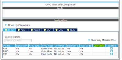

Hello @siyar ,
I suggest that you take a look at UM1718 section 4.5.12 GPIO configuration window.
Under User Label, you can change the default name (such as GPIO_input) into a user defined name.
The Pinout view is updated accordingly.
Thanks.
Mahmoud

Of course you cannot "find" those pins; you have to define and name them yourself. They are not part of the SPI port, but GPIO's that have been given a user label.
