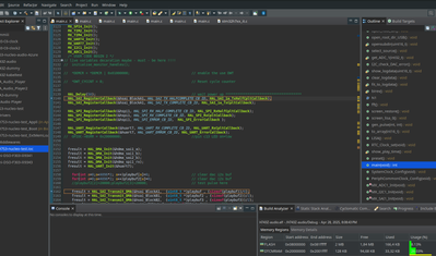

2025-05-02 5:53 AM - edited 2025-05-02 6:20 AM
...this is how my IDE is looking:

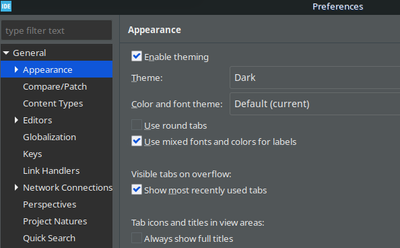

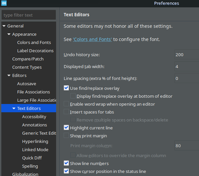

So more save: use the settings, that are already here: menu -> window -> preferences
- first:

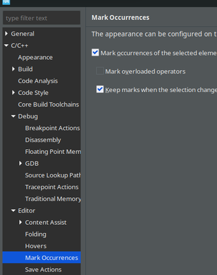

- then: many ...editor, debug etc.

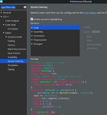

- and the syntax colors you like:
- and what it shows in menu and tollbars :

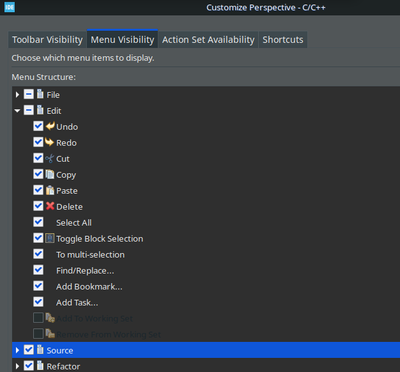

/for every perspective ! / edit / debug / Mx
menu-> window -> perspective -> customize...

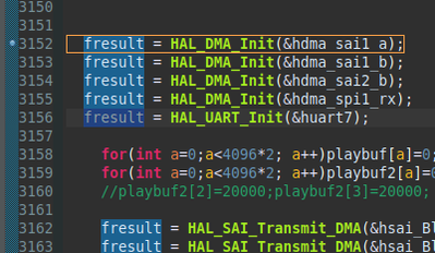

btw - what i like : mark occ. of sel. text

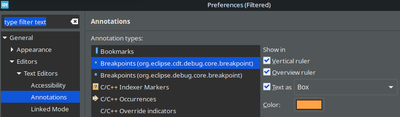

- and breakpoints better visible:
-> here : marked text "fresult" and a breakpoint
