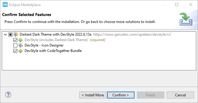

  • Click Help->Eclipse Marketplace....
  • Search DevStyle
  • Click Install beside Darkest Dark Theme with DevStyle 2022.6.13a
Then I leave the default components selected and I click on the Confirm button:

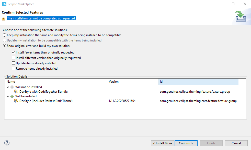

after processing the click for about 20 seconds, I get the following error displayed:
The installation cannot be completed as requested.
If I click Show original error and build my own solution radio button I get:

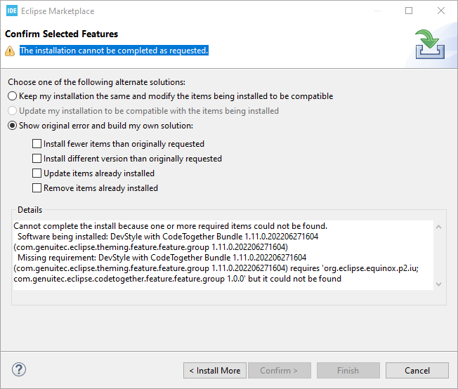

Here is the specific error message copy/pasted:
Cannot complete the install because one or more required items could not be found.
  Software being installed: DevStyle with CodeTogether Bundle 1.11.0.202206271604 (com.genuitec.eclipse.theming.feature.feature.group 1.11.0.202206271604)
  Missing requirement: DevStyle with CodeTogether Bundle 1.11.0.202206271604 (com.genuitec.eclipse.theming.feature.feature.group 1.11.0.202206271604) requires 'org.eclipse.equinox.p2.iu; com.genuitec.eclipse.codetogether.feature.feature.group 1.0.0' but it could not be found
If I then select "show original error and build my own solution" and select Install fewer items than originally requested then it appears to break the IDE because I can no longer build my project after the IDE restarts following the partial install

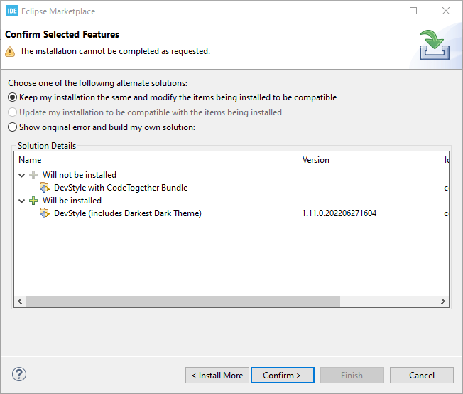

If I select Keep me installation same and modify the items being installed to be compatible option then it does the same thing (i.e. DevStyle with CodeTogether Bundle will not be installed.
