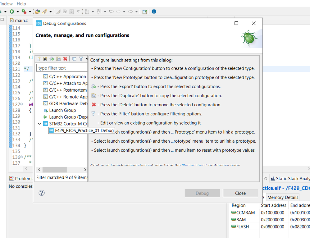

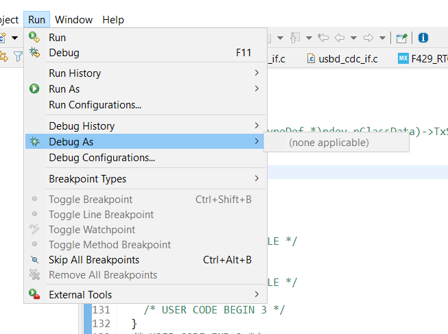

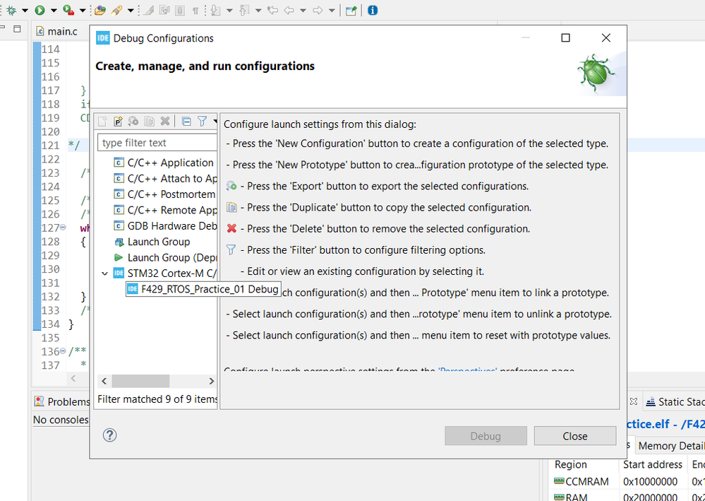

The point is that I cannot create nor edit a debug configuration. If I click Run > Debug As I don't have any configuration available (even if I import the project from another system that runs perfectly fine with same software versions - I don't have its debug configuration - the file is in the system, yet is not interpreted by IDE; see "Screenshot_1.png"). If I try to create a new configuration - IDE gets stuck and does not respond anymore (see "Screenshot_2.png" and "Scfreenshot_3.png" - in fact they are almost identical - no pop-up window appeared, and IDE got stuck). I've been thinking of some problem with GDB server or maybe toolchain, but until now - I could not find a solution.

Probably SOLVED.
I will try not to use mean language, but the #$%^#^#^ firewall was blocking GDB server...
I will test to fully confirm the that it was really the problem.
