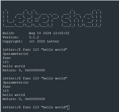

2024-08-12 8:39 AM
I want to use ThreadX and a Command-Line called letter-shell with CubeIDE, used a uart lib(lwrb) but changed it to HAL, but it will crash when send an costum command. Send string is "func 123 "hello word"".
Here are a few of the ways I've tried:
First, it works well without ThreadX when using CubeIDE, still used a uart lib(lwrb) but changed it to HAL. Here is the repository(link).
Second, I tried porting the program to MDK, everything is same but compiler. The project of CubeIDE and MDK are both in this repository(link).
Third, I increased the heap and stack when using CubeIDE and ThreadX, it does not work.

I think the reason why it could execute on MDK is that MDK has Micro lib, printf in MDK will not use much stack.

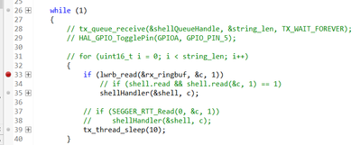

VOID shellThread(ULONG id)
(void)id;
char c;
/* usart ringbuff initialization */
lwrb_init(&tx_ringbuf, tx_ringbuf_array, sizeof(tx_ringbuf_array));
lwrb_init(&rx_ringbuf, rx_ringbuf_array, sizeof(rx_ringbuf_array));
uart_init(&huart2);
rtt_init();
userShellInit(&shell);
while (1)
if (lwrb_read(&rx_ringbuf, &c, 1))
shellHandler(&shell, c);
// if (SEGGER_RTT_Read(0, &c, 1))
// shellHandler(&shell, c);
tx_thread_sleep(10);
}The above code is the only one task that I created, specifically using the letter-shell to handle characters.

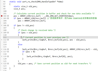

static void uart_rx_check(DMA_HandleTypeDef *hdma)
static size_t old_pos;
size_t pos;
/* Calculate current position in buffer and check for new data available */
pos = ARRAY_LEN(recv_buf) - __HAL_DMA_GET_COUNTER(hdma);
if (pos > ARRAY_LEN(recv_buf)) // 数组越界保护,因为DMA COUNTER会返回错误的数值
pos = ARRAY_LEN(recv_buf);
if (pos != old_pos)
/* Check change in received data */
if (pos > old_pos)
/* Current position is over previous one */
lwrb_write(&rx_ringbuf, &recv_buf[old_pos], pos - old_pos);
else
lwrb_write(&rx_ringbuf, &recv_buf[old_pos], ARRAY_LEN(recv_buf) - old_pos);
if (pos > 0)
lwrb_write(&rx_ringbuf, &recv_buf[0], pos);
old_pos = pos; /* Save current position as old for next transfers */
static void dma_recv_HT(struct __DMA_HandleTypeDef *hdma)
uart_rx_check(hdma);
static void dma_recv_TC(struct __DMA_HandleTypeDef *hdma)
void HAL_UARTEx_IdleCallback(UART_HandleTypeDef *huart)
if (__HAL_UART_GET_FLAG(huart, UART_FLAG_IDLE) != RESET)
__HAL_UART_CLEAR_IDLEFLAG(huart);
uart_rx_check(huart->hdmarx);
}In the uart_init(&huart2); , I enabled DMA_IT_HT, DMA_IT_TC, and UART_IT_IDLE, any interrupt will write the data to the ringbuff rx_ringbuf. Then, the task will get a char from the ringbuff rx_ringbuf and use letter-shell to handle it.

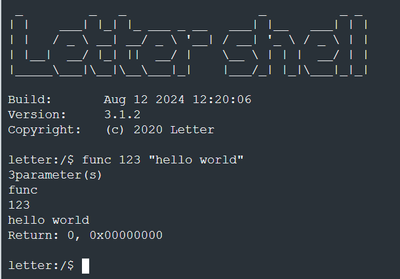

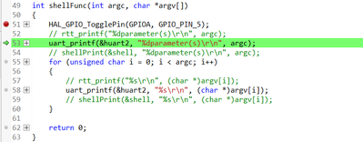

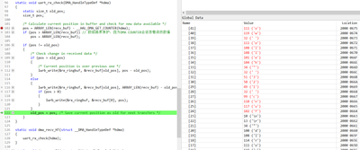

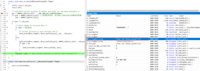

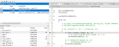

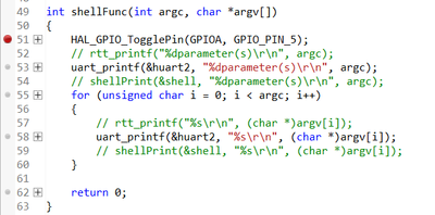

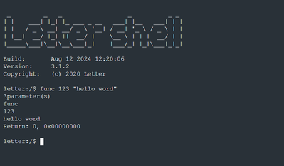

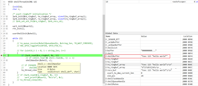

Here's how I debugged:
Break points in the loop of the task, the costume command function, the common execution part of the UART interrupt.
Start project.
Send "func 123 "hello word"" from PC, the ringbuff rx_ringbuf is written correct data.
The letter-shell got the correct data from the ringbuff rx_ringbuf.
The costume command function has been executed, as the first picture see.
However, even the break point in the task still exist, it won't stop. The task can't be executed again.
But UART interrupt still works, it could write correct data into the ringbuff.
I tried to switch UART to SEGGER RTT, it's still the same phenomenon. The command still could be executed just once, then the task will not be executed again.
