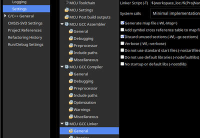

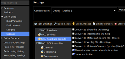

build analyzer = flash, ram used , you dont see in debug , just after compile you can see it.
-> for project, you select (= focus is on it)
see: -> selected project
then see:
in settings you must not disable this in project settings:

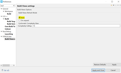

Hello @DLid.1 ,
If you are using CubeIDE 1.15.0, you need to enable 'Auto' for the build views refresh mode in [Window]>[Preferences]>[STM32Cube]>[Build Views Settings], then restart CubeIDE.
Thanks,
Rim.

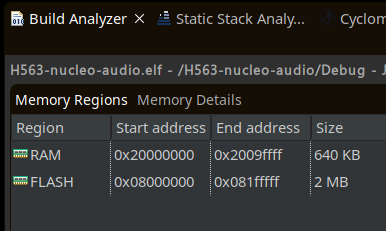

2024-11-28 7:39 AM
Hello @MiguelDK
After following the steps mentioned by Rim, you have to click on the 'Refresh' button:
KR,
Souhaib

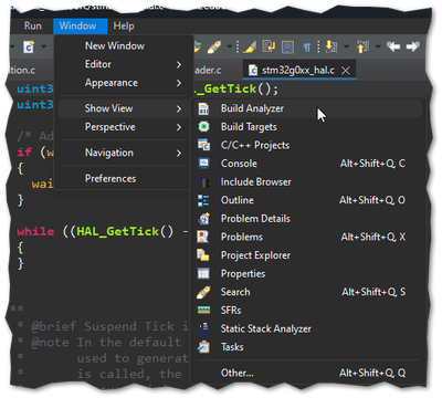

2024-11-28 10:59 PM
Hi Souhaib
I don't get a window with the buttons that you show.
If I press [Window]>[Show View]<[Build Analyzer] nothing seems to happen.
Right now, I'm considering to reinstall CubeIDE to solve the problem, but it would be nice if I don't need to...
BR Miguel

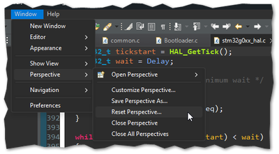

2024-11-28 11:13 PM
Hi
I have now solved the problem.
I had to press: [Window]>[Perspective]>[Reset Perspective...]
This brought back the Build Analyzer
