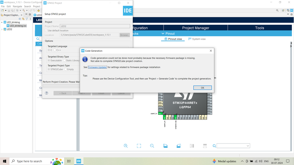

2024-07-29 11:08 PM - last edited on 2024-07-30 2:35 AM by Andrew Neil
Code generation could not be donemost probably because the necessary firmware package is missing. Not abe to complete STM32Cube project creation. See Firmware updater for settingrelated to firmware package installation.

Hello @Aman1 and welcome to the community,
Try to check the connection under Window->Preferences->Firmware updater, then login to myST. The firmware will be successfully downloaded.
Thanks,
Rim.

Did this worked out for you @Aman1 ? @Rim LANDOLSI following the Window -> preferences->Firmware Updater path I can'
t find any window to log in for myST.
2025-05-03 7:03 AM
The login is in : menu -> help -> STM32cube updates -> connection to myST
