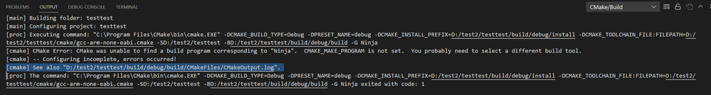

2023-03-17 12:28 PM
[main] Building folder: testtest
[main] Configuring project: testtest
[proc] Executing command: "C:\Program Files\CMake\bin\cmake.EXE" -DCMAKE_BUILD_TYPE=Debug -DPRESET_NAME=debug -DCMAKE_INSTALL_PREFIX=D:/test2/testtest/build/debug/install -DCMAKE_TOOLCHAIN_FILE:FILEPATH=D:/test2/testtest/cmake/gcc-arm-none-eabi.cmake -SD:/test2/testtest -BD:/test2/testtest/build/debug/build -G Ninja
[cmake] CMake Error: CMake was unable to find a build program corresponding to "Ninja". CMAKE_MAKE_PROGRAM is not set. You probably need to select a different build tool.
[cmake] -- Configuring incomplete, errors occurred!
[cmake] See also "D:/test2/testtest/build/debug/build/CMakeFiles/CMakeOutput.log".
[proc] The command: "C:\Program Files\CMake\bin\cmake.EXE" -DCMAKE_BUILD_TYPE=Debug -DPRESET_NAME=debug -DCMAKE_INSTALL_PREFIX=D:/test2/testtest/build/debug/install -DCMAKE_TOOLCHAIN_FILE:FILEPATH=D:/test2/testtest/cmake/gcc-arm-none-eabi.cmake -SD:/test2/testtest -BD:/test2/testtest/build/debug/build -G Ninja exited with code: 1
2023-03-23 4:37 PM
Yes, check that vcpkg is activated by this icon in the status bar. It does not look like it based on the output you posted.
If you are getting a vcpkg activation error you can post an issue in our Embedded Tools issue list as that is where it is bundled. We'll look into it.
