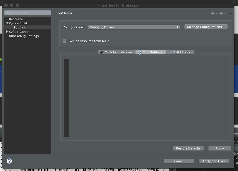

Being able to create a new project from an existing .ioc file is very useful. But when I've tried to do this (by selecting File->New->STM32 Project from STM32CubeMX .ioc file) the project seems broken. I can build it fine, but when I try to add new (existing) source files to the project (either by dragging and dropping or importing), they appear in the IDE but are never actually built. If you inspect the properties for newly added source files, the Tools Settings section is empty. If I create a new, blank, project, I'm able to add source files fine. Is this feature broken, or am I doing something wrong?

Eclipse CDT has some quirks (not specific to CubeIDE) so perhaps you're doing something wrong.
Try to add a file by placing it in a source directory and refresh the project.
If the folder where you want to add a file is virtual (aka "linked"), this should be done in a different way:
right click on the folder -> New-> FIle or File from template or Advanced-> Link to file in the filesystem.
-- pa

I tried every method of adding files I know (drag and drop, import, and putting them in the folder), none of them worked. In the end I worked around it by creating a new project, and then copying the .ioc from the original project, renaming it, and adding it to the new project. This worked, and I was able to add files fine. It seems there is a bug with the 'create new project from .ioc' feature. This is version 1.3.0 of the IDE.
