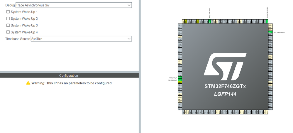

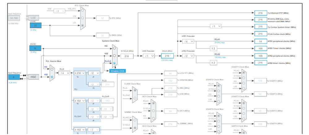

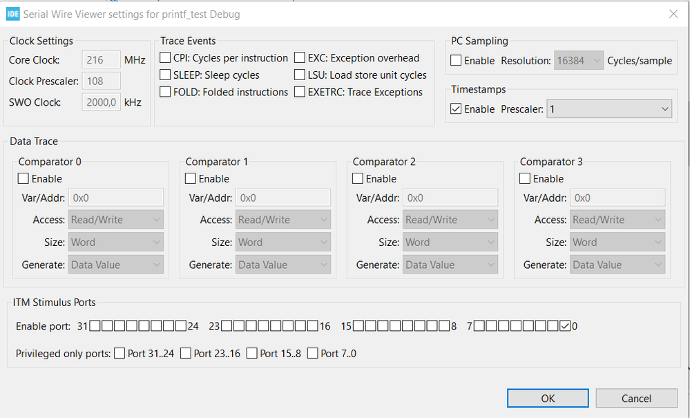

Enable SWV in debug configuration. Set Core clock as a HCLK in ioc file(216MHz)
And run debug. In debug open SWV ITM Data Console and enable port 0 and start trace.
(this screen from cubeide)
In truestudio everything works fine. Do the same steps in Stm32CubeIDE 1.4.2(Also generate files from zero from new ioc, because if i opened the same ioc i generated for truestudio and regenerate it for stm32cubeide, i can not build it because of errors in syscalls about reimplementation of some functions) and see nothing in SWV ITM Data Console. What am i missing???
