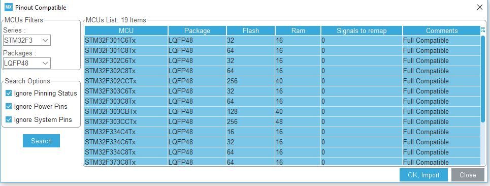

What do you mean migrating between MCU is not supported ? Did you search and select "List Pinout Compatible MCUs" from the Pinout menu ?
