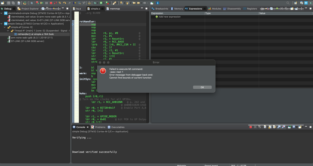

2021-05-29 1:36 PM
Thanks Markus.
I unchecked Resume in the Debug Configuration Tab. The program stops at rstHandler (Reset vector location). There is no explicit BP set there.
But I cannot step from there on.

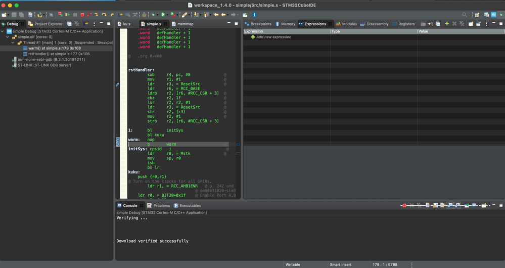

2021-05-29 1:45 PM
I reverted to "Resume" ticked on again.
This time the first breakpoint is hit right on. Setting then another breakpoint further down (see screenshot) at "warm: nop" you can see the BP arrow being one off.
So the problem persists.
2021-06-01 2:33 AM
Any new findings? The issue is still there as you can see from the screen shot and it is not that it just happens at the Reset (rstHandler) entry point. I need to use breakpoints. How else should I be able to start my program and run it to a specific point of make use of all features that are possible with breakpoints (like conditions, counts, to name at least two)?
