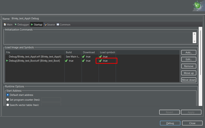

2025-08-02 2:16 AM
Hi @MHoll.2 ,
Enabling the "Load symbols" option has resolved the initial issue.
However, there's a new issue with the code generated by CubeMX. It seems to get stuck at the SCB_EnableDCache() function for a while before jumping to the Error_Handler(void). I suspect there might be a configuration problem with the template code for the NUCLEO-H7S3L8.

2025-08-02 2:16 AM
Hi @MHoll.2 ,
