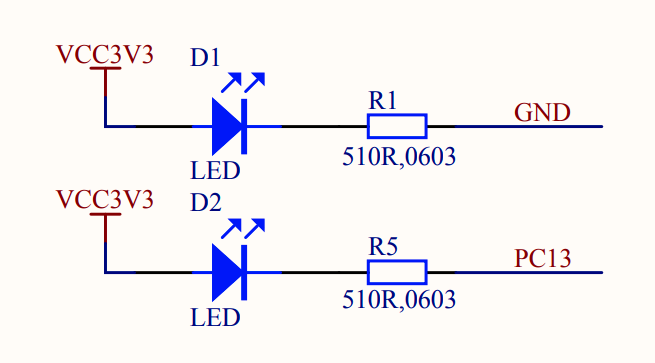

I've been having issues with my bluepill chip ( stm32f103c8t6) concering its significant current draw . I know that bluepills aren't the best choice for low power projects but they should at least draw less than 670µA in stand by mode ( according to the PCC tool in cubemx) . I've also heard people say that removing the built in LEDS(PC13 and PWR led) will reduce the current consumption drastically , is it true and is it safe to just desolder them ?

What is "significant current draw"?
Removing LEDs will certainly help. D1 and D2 draw about 3mA each. D2 only draws current if PC13 is low.
