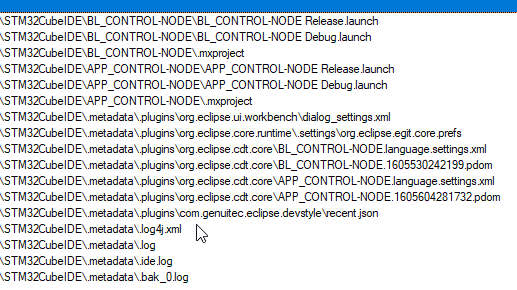

Now I cleaned and rebuilt the projects (both debug and release) then scanned for references to the original project's path.
Here is a list of the files still containing references to the old project folder:
In .mxproject the only references are under [PreviousGenFiles], I think this should not be a problem.

Now I did a manual search and replace in config files only, no binary files, no log files, no .lnk files, etc.
If your old path has a slash in the directory path that has to be removed beware that the slash can be written as \, /, \\, //, \/, etc. in the config files - this is an additional problem.
For search and replace I found "InfoRapid Search & Replace" to be very useful.
These are the files in which I did a manual path replace: .mxproject, .log4j.xml, *.launch, dialog_settings.xml, *.prefs, *.json
