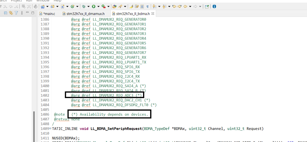

2021-12-07 5:38 AM
also h723 has error in bdma partition. bdma's register are not available in cube ide. only it have IFCR,ISR.

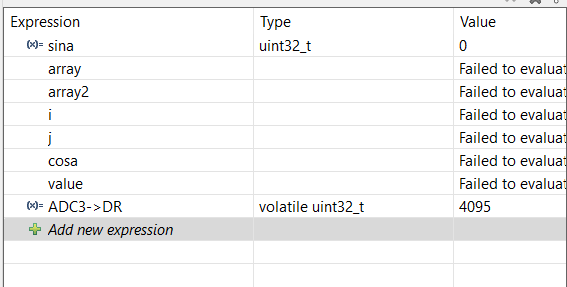

2021-12-07 6:26 AM
adc works but dma does not send data

2021-12-07 6:34 AM
Is sina[] in SRAM4 (0x38000000) ?
If the BDMA throws a Transfer Error, probably not..
2021-12-07 6:38 AM
> I was wondering if bdma can be used with adc3.
Yes. BDMA is hooked up to DMAMUX2 per the reference manual. DMAMUX2 is connected to ADC3 through requests 26/27 (ADC3_IT/ADC3_AWD). See "17.3.3 DMAMUX2 mapping".
