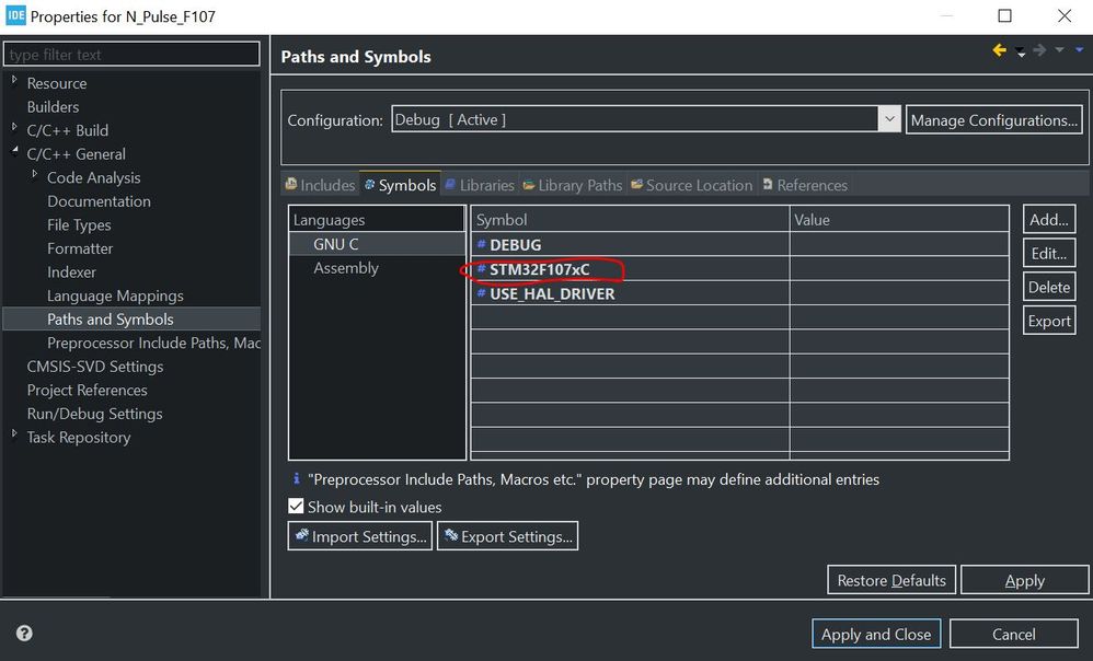

In cubeIDE there is a symbol defined in compiler settings:
2020-08-04 7:39 AM
very true, all compilers have compile options and label names. only drawback is syntax is compiler dependent and not part of source code. a global include file is another way.
