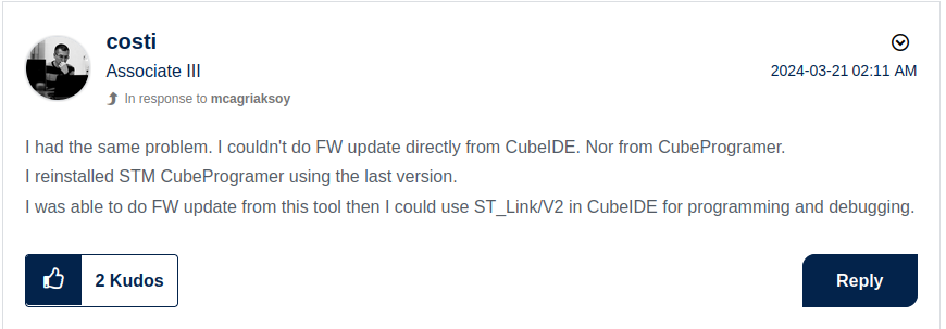

Hi. I have the latest version 1.15.0. I had seen that several users also had this problem, but it was because they were using a "ST-Link/V2" clone. Now I'll follow the thread to see if it gets resolved. Thank you very much for the information. Regards.
2024-03-26 10:53 AM
I just found the solution. Costi suggested installing the firmware from CubeProgramer, and that's how I succeeded. I installed the latest version and updated the firmware from there. I had to unplug the board and plug it in with the reset button on. That was it. And when I tried STMCubeIDE, it suggested updating and I said No. And voila, it worked perfectly
