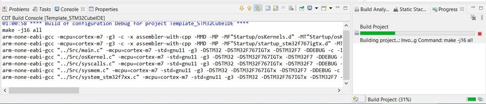

I have an assembly file which contains something like :
AREA |.text|, CODE, READONLY, ALIGN=2
THUMB
EXTERN currentPt
EXPORT SysTick_Handler
EXPORT osSchedulerLaunch
;some code here
ALIGN
ENDwhich compile and work in keil . but when I put this file in stm32cubeide it will go to 31% for compiling and then will stop :
What Is The Problem :expressionless_face: ?

2021-04-23 12:10 AM
So what should I do ? any reference about this differences and how to change them to work ? any example ?
2021-04-23 1:07 AM
find out by adding these:
.syntax unified
.cpu cortex-m7
.fpu softvfp
.thumband changing function to something like this :
.section .text.osSchedulerLaunch
.weak osSchedulerLaunch
.type osSchedulerLaunch, %functionit will compile if I remove "Systick_Handler" part of my assembly file the systick part is :
SysTick_Handler:
CPSID I
CPSIE I
BX LRwhat should I put before this function to get to work . ( when I add function attribute like osSchedulerLaunch it will hang on compiling again )
