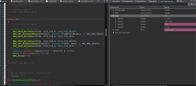

2024-09-01 9:43 AM
const uint16_t ANGLECOM = 0b0111111111111111;
const uint16_t NOP = 0b0100000000000000;
uint8_t data[4];
float angle = 0.0;these are my global variables and this is my main code now
while (1)
/* USER CODE END WHILE */
/* USER CODE BEGIN 3 */
HAL_GPIO_WritePin(GPIOA, GPIO_PIN_4, GPIO_PIN_RESET);
HAL_SPI_TransmitReceive(&hspi1, (uint8_t*)&ANGLECOM,data, 2, HAL_MAX_DELAY);
HAL_GPIO_WritePin(GPIOA, GPIO_PIN_4, GPIO_PIN_SET);
HAL_SPI_TransmitReceive(&hspi1, (uint8_t*)&NOP, data, 2, HAL_MAX_DELAY);
uint16_t value = ((data[2]<<8) | data[3]) & 0x3FFF;
angle = (float)value*0.02197f;
HAL_Delay(250);
}the angle value is 180 but in the live expressions it is not changing when i rotate the motor
