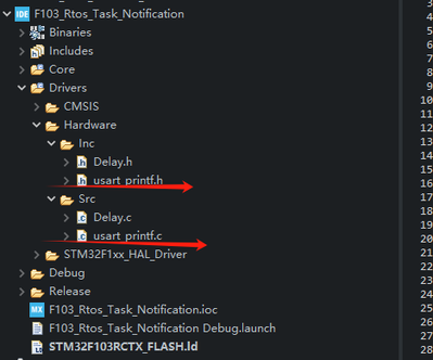

After I use STM32CUBEIDE's built-in STM32CUBEMX to generate code, the source files and header files under the folder I created myself disappeared, how can this be solved?
Before I use STM32CUBEIDE's built-in STM32CUBEMX to generate code:

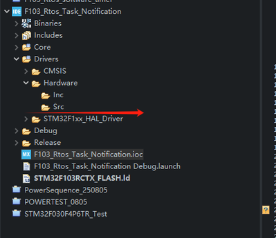

After I use STM32CUBEIDE's built-in STM32CUBEMX to generate code,all the files I created disappeared.

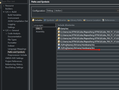

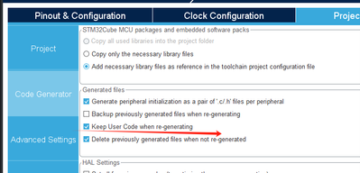

The compilation path of the file I created has already been saved, and I also checked the keep user code when re-generating option

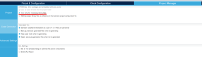

Could you please check the copy only the necessary files, this is will keep your custom files.
KR,
Souhaib
2025-08-13 8:16 PM
I checked this option and changed it to the next option, but the problem persists

Hello @sky_lin
Thank you for your detailed explanation.
The dedicated team are already aware of this issue (Internal Ticket number 196837), and fix will be implemented soon. In meantime, I recommend not placing your folder inside any CubeMX-generated directories (Drivers, Core, Middleware). Instead, please place it directly under the project root.
