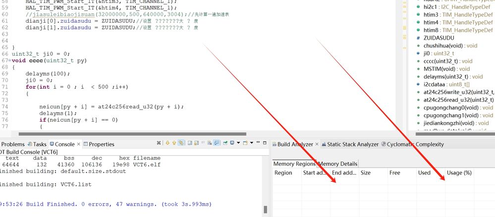

I remember that after the program was compiled, the ROM and RAM ratios were displayed in the lower right corner, but now it is gone and I don’t know how to reset it. I need help

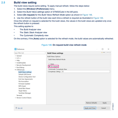

Hello @wsnfly ,
First let me thank you for posting and welcome to the ST Community.
I suggest that you click on " Refresh Build Analyzer"
I suggest also that you refer to UM2609, section 2.5 where this new button is explained and how you can change the behavior.
Thanks.

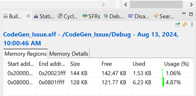

2024-08-13 4:19 AM - edited 2024-08-13 4:28 AM
Thanks.It can already be displayed
