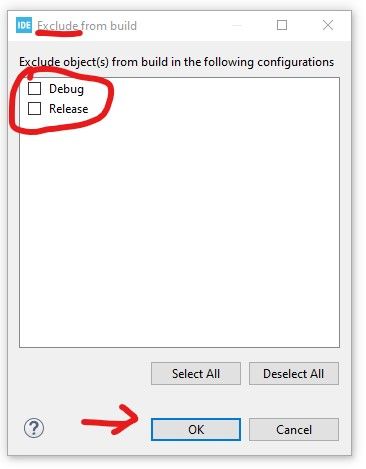

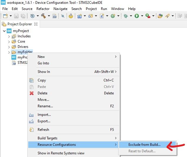

@RHerm.3 If aiming to add your own folder instead Core/.... let's rely on project contextual menu to add source entry(ies)
Small "C" green overlay icon should appear as your new included folder decoration

Put them in a folder where other source files are. Typically, this is in Core/Src.
You can put them in a separate folder, but then you need to mark it as a source folder so they get compiled.
Header files can go anywhere in the include path. Typically, this is in Core/Inc.
