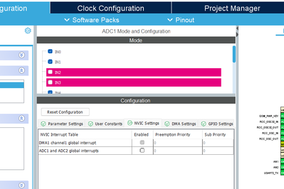

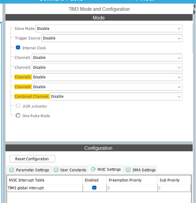

In a project built using STM32F103, I have used TIM3 for some of my frequent tasks (like LED blinking and setting some flags etc.), which work perfectly. Today when I tried to enable ADC1 using DMA Circular, it looks like the TIM3 Global Interrupt handler is not invoked..
This line of code, stops the TIM3 interrupt.
HAL_ADC_Start_DMA(hadc, adcBuffer, 5)
I don't find any relation between these 2. How ADC1 is related to TIM3? I am not using any channels of TIM3, just using its time elapsed event to do my tasks. Scratching my head.. Please help.

If there is an interrupt related to ADC or DMA and it's too lengthy, and the TIM3 interrupt's priority is lower or equal to that interrupt's priority, this may result in behaviour you've described.
One way to debug this is to toggle a pin at the interrupt-in-question's entry and exit and observe on oscilloscope/LA.

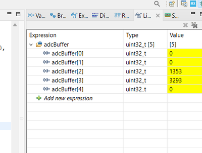

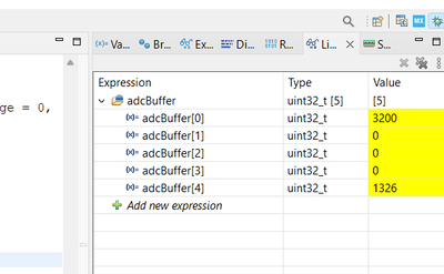

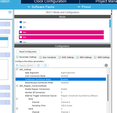

Now, I have another question.. Instead of circular dma, I just did it normal dma.. and I call the ADC_Receive_DMA every 2 secs (from my main loop). I have voltage supplied into 2 channels out of 5. Now at every interrupt call, the value of the DMA buffer looks funny... The position of the channel 8 and 9 position keeps changing in the DMA buffer.. Below are 2 screenshots from the live expression..
Here is the adc related code..
uint32_t adcBuffer[5] = { 0 }; //We are reading 5 channels
void HAL_ADC_ConvCpltCallback(ADC_HandleTypeDef *hadc) {
if(hadc->Instance == ADC1){
//Doing nothing for now
uint8_t ADC_Read(ADC_HandleTypeDef *hadc) {
if(HAL_ADC_Start_DMA(hadc, adcBuffer, 5) == HAL_OK){
return 1;
return 0;
The ADC_Read() is called from main loop every 2 seconds..
