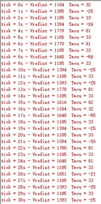

Oh, sorry.
In the above given test (the second test), the storage buffer size was indeed not changed to [6], however I just did a new test with the storage buffer size changed to convertedData[6], and got the same result:
It keeps reading out the same 6-second data pattern. the Vrefint should always be read out 1184mv or 1185mv, but I got only 2 correct readings every 6 seconds, why it's 6? what's its relationship with 6 channels?), why the readings are wrong for the other 4 seconds?

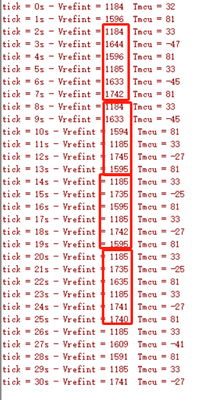

Although the one second timing is not the best implementation of a one-second timer, but it could be enough for a simple ADC test, as it works in my ADC tests on Nucleo-G070RB board. As stated in my reply to raptorhal2 earlier, the wrong reading is periodical, it repeats every 6 seconds, I don't know whether or not it's associated with the number (6) of conversion channels.
I just increased the number of channels from 6 to 8, and the ADC readings look in the same pattern as in 6-channel test: repeat every 6 seconds:

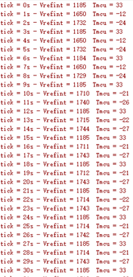

But when changed the number of channels to 4, the ADC readings seem different:
