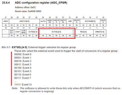

From architectural point of view it's not possible to trigger different channels of the same ADC with different timers. Because you can only select one event at a time:
From the reference manual
