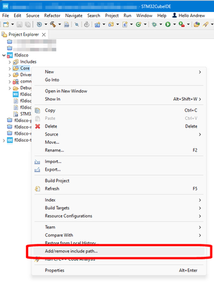

2024-01-25 2:37 AM
Note that you can also specify a folder as an Include Path by right-clicking in the Project Explorer:
