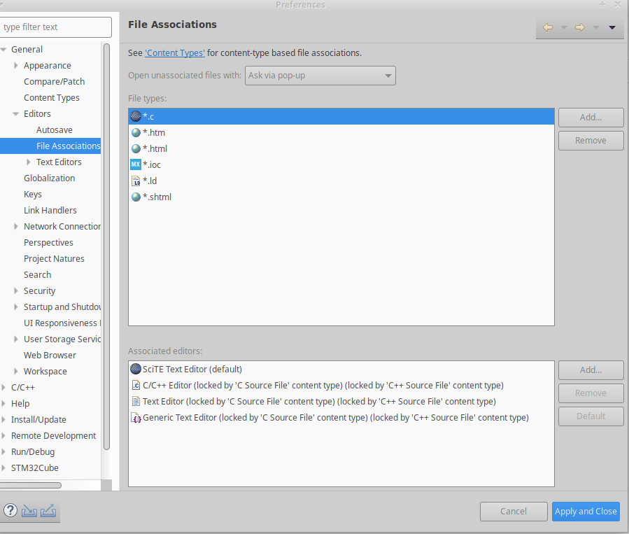

File association can be accessed through [Windows -> Preferences -> STM32Cube -> File Association] as well as [Windows -> Preferences -> General -> Editors -> File Associations].

Not a solution, but a workaround (as it does not provide recovery of existing data, it only prevents the problem to occur in a new project):
The SWT Error Issue indeed seems to be associated with the internal editor of Eclipse, as defining a file type *.c and associating it with an external editor (e.g. Scite) seems to help. One has to do it before a generated file is opened.
