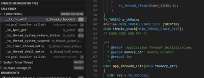

During a debugging session, when `tx_thread_create` is called with a "big" stack size (1024*10 for example) and the "serverRtos" is enabled, the debugger is disconnected with an error: "Remote communication error. Target disconnected: No error."
Here the debug console logs (full log attached):

Everything runs as expected in CLion and STMCubeIDE, but when I use the exact same code in VSCode, I have the issue.
Can you reproduce the bug with the project I shared with you?
Is there any additional information I can provide to help move forward?

2025-10-28 6:47 AM
The thread creation with min stack size "#define MAIN_THREAD_STACK_SIZE (1024*10)" is causing overlap between .bss and ._user_heap_stack
to fix that you can define the creation of the main thread task as following:
instead of:
.bss usage and preventing overlap.
2025-10-28 7:30 AM
Thank you for taking the time to help me.
I tried implementing your suggestion, but unfortunately it doesn't work any better. The issue persists even after allocating the stack from the ThreadX byte pool as you described.
I have the impression that the problem is elsewhere because it works correctly on STM32CubeIDE.
2025-10-28 7:59 AM
2025-10-28 8:15 AM
It doesn't crash because the thMain_stack failed to allocate so the thread is not created.
You must extend the TX_APP_MEM_POOL_SIZE
