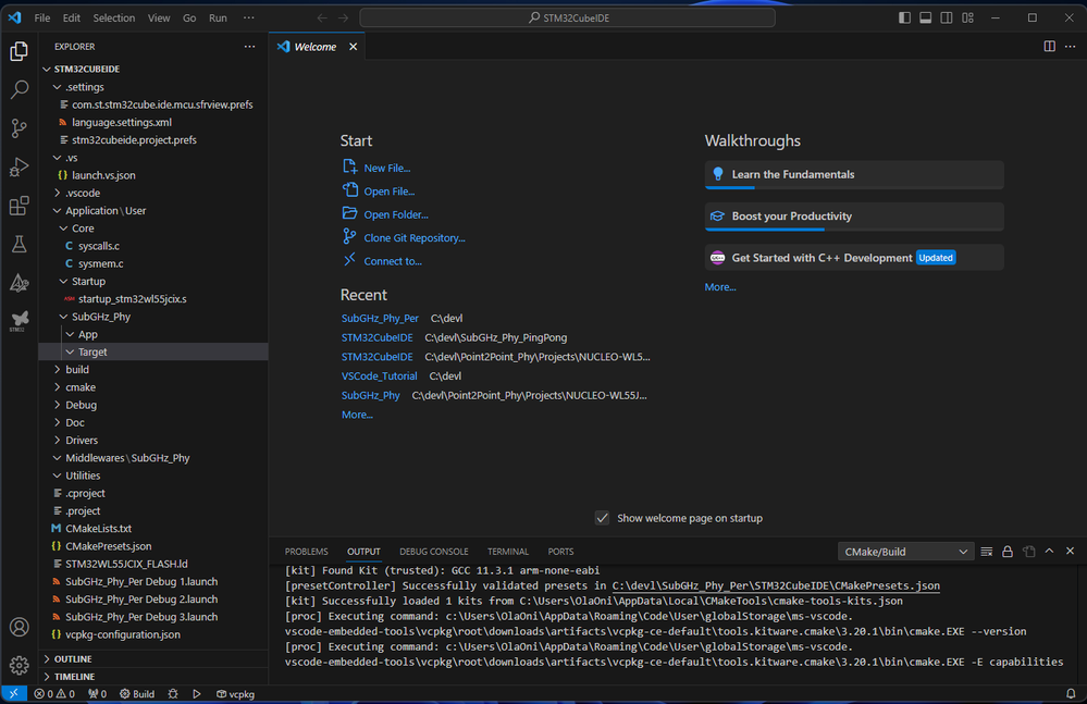

When I load STM32CubeIDE .cproject in VSCode the only source files that are shown are files in Core/syscalls.c, Core/sysmem.c and Startup/startup_stm32wl55jcix.s
The project builds successfully when imported and I can even start debug but I can not see main.c. If I load the same project in STM32CubeIDE all the files show correctly.
I have tried re-installing Visual Code and STM32 VS CODE EXTENSION
Any idea on what is happening.
2023-12-06 3:24 AM
To add some more information to the above bug report. This bug is only visible when I use the example project from the Example Selector option that STM32CubeMX presents. The example project that I was trying to load was the SubGHz_Phy_Per project.
However if I start using the Board Selector option then the project created load correctly in VS code.
