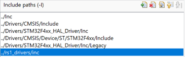

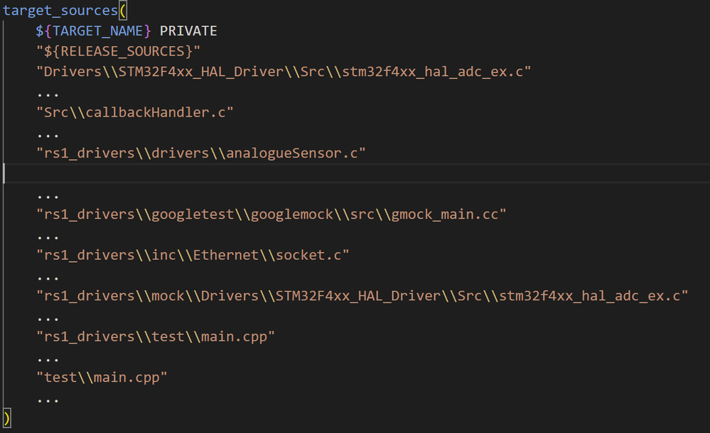

Looking into this further, it looks like the import tool does not recognize workspace includes as shown,
I changed the include path to a relative path and resolved this problem,
However, I still require manual removal of excluded target sources. It looks like the importer is including all source files in the workspace recursively instead of using the files specified in the paths and symbols options. In this case, the target_sources is including my testing and mocking files that are intentionally excluded from the source paths. Note: I was incorrect in my initial comment that files excluded from build were showing up, it was these files that the imported added that were causing issues.

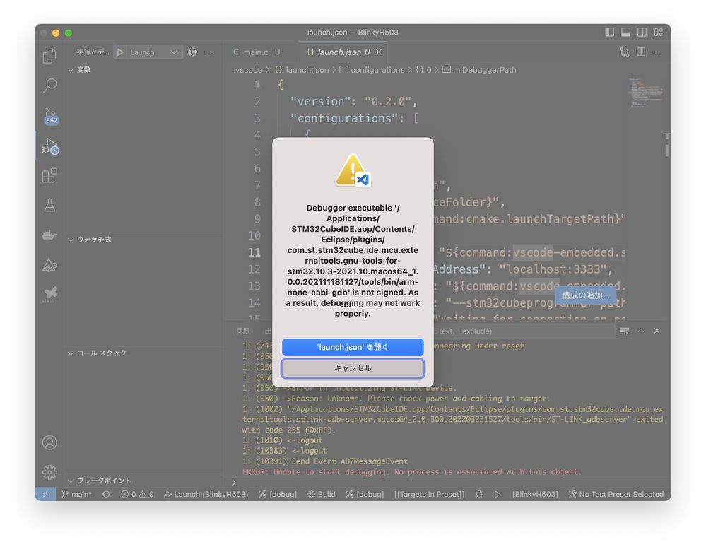

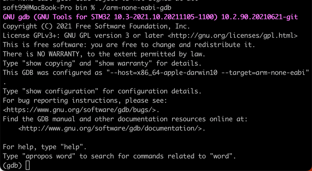

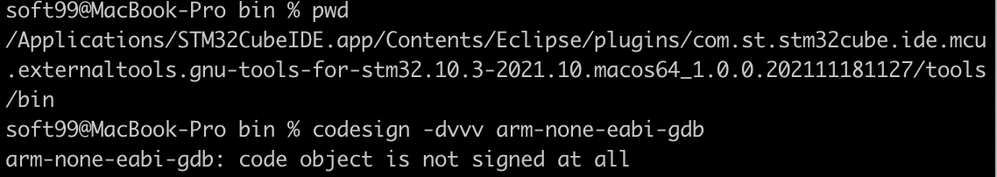

I face the problem gdb cannot run on MacOS Ventura 13.3.1 (a) on M1.
I got this error message at stating gdb.
It seems that gdb is not signed.
I confirmed that it is not signed.
However, I can run it on terminal as;
How to solve my issue?
Please give me your idea. Thanks.
