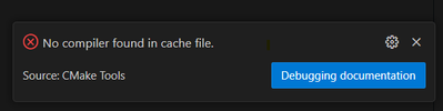

3. Try to "Debug" the project but it shows error message :
Questions :
For STM32CubeIDE, it is using OpenOCD.
For VSCode, How to configured and setup to use the Debug Tools under STM32CubeCLT ?

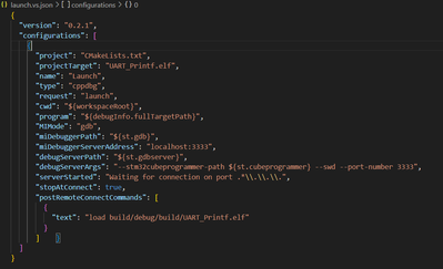

2024-02-29 4:33 PM
Anyone knows how to update this for the Tools required for debugger ??
2024-03-01 8:33 AM
Issue resolved by re-installed both
- STM32CubeIDE and STM32CubeCLR to default location "C:\ST"
Looks like both tools are inter-connected to each other in un-documented manner.
