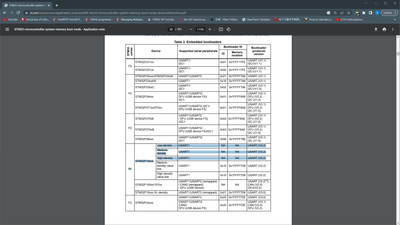

Yes, BL should be able to launch from ROM no matter Flash contents are. But I notice that this F103C8 belongs to 'Medium density performance line' from datasheet. However in AN2606, it says both ID and Address for this line are N/A. Does it mean no BL at all?

Dear @ming2 ,
STM32F103 ( Medium , Low and High density) are first STM32 from the F1 series put in production and are still running on high volume even now. Initially we do not provide a signature in the system memory to identify the Bootloader version that was added starting from STM32F1 Value line and then on all series. I confirm that the product contain the bootloader thru UART protocol ( version 2.2). I Have two options proposal for such issue :
1) Try to reduce the Baudrate for example 56K or less and see if the occurrence of connection increase or decrease .
2) if the same issue is happening when using Cubeprogrammer thru SWD or JTAG ?
Hope it helps you.
STOne-32
