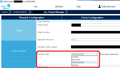

I'm proposing a new option for "Toolchain / IDE" selection. How would that affect anyone's existing projects, or prevent them from using anything?
Which option? a new type of CMake project?

Oh, I see later versions of CubeMX have a CMake option in the pulldown (contrary to my screenshot). I'm in the process of updating our project to use later CubeMX and libs...
