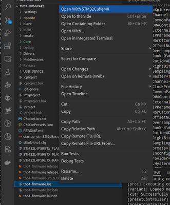

First, STM32CubeMX is not the default action when clicking on the IOC file. It is rather surprising that it is opened in a text editor in VSCode. However, the real problem is that when I right-click on the IOC file in VSCode and select "Open with STM32CubeMX", STM32CubeMX starts up, begins reading the IOC file, and just hangs, never completing the action. This is all I see:
The window is unresponsive. I cannot close it. I need to then manually find the Java process and kill -9 it to resume normal operations. If I start STM32CubeMX manually from the command-line, it works fine. I have verified that both are using the same JRE.

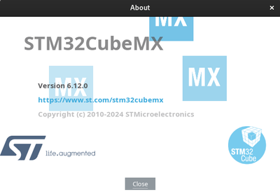

I am running STM32CubeMX 6.12.0.

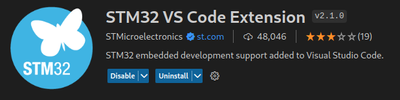

OS: Linux x64 6.9.9-100.fc39.x86_64
I verified that I am running the new version of the STM32 plugin.

2024-07-23 10:37 AM - edited 2024-07-23 10:44 AM
Looking at this more closely, this is coming from Microsoft's Embedded Tools Extension. The STM32 VS Code Extension provides no way to easily open an existing IOC file directly from the VSCode UI.
So, to be clear, the problem with STM32CubeMX hanging when launched from VSCode is occurring in Microsoft's Embedded Tools Extension, not in STM32 VSCode Extension.
